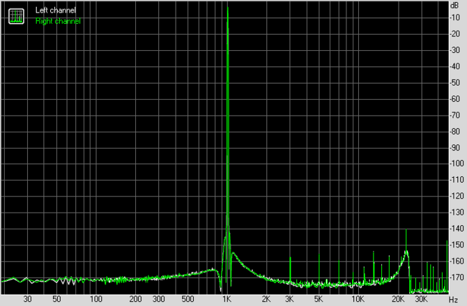

Sound Blaster AE-7: 24-bit/96 kHz (wyjście słuchawkowe)
Tym razem wyniki pomiarów są zbliżone do testu wyjścia liniowego przy identycznych parametrach sygnału. Poziom szumów spada do -149,4 dB, nieznacznie wyższe są wartości parametru przesłuchu międzykanałowego. Pozostałe parametry są identyczne, jak w przypadku pomiarów wyjścia liniowego.
RightMark Audio Analyzer test report
Testing device | AE-7 24-bit 96 kHz headphones |
Sampling mode | 24-bit, 96 kHz |
Interface | |
Testing chain | External loopback (line-out - line-in) |
RMAA Version | 6.4.5 |
20 Hz - 20 kHz filter | ON |
Normalize amplitude | ON |
Level change | -0.0 dB / -0.0 dB |
Mono mode | OFF |
Calibration singal, Hz | 1000 |
Polarity | correct/correct |
Summary
Frequency response (from 40 Hz to 15 kHz), dB | +0.00, -0.00 |
Excellent |
Noise level, dB (A) | -149.4 |
Excellent |
Dynamic range, dB (A) | 133.1 |
Excellent |
THD, % | 0.00001 |
Excellent |
THD + Noise, dB (A) | -127.9 |
Excellent |
IMD + Noise, % | 0.00022 |
Excellent |
Stereo crosstalk, dB | -145.3 |
Excellent |
IMD at 10 kHz, % | 0.00003 |
Excellent |
General performance | Excellent |

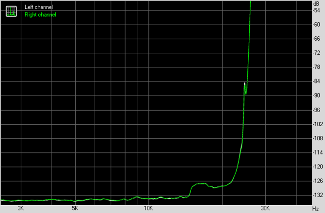

Frequency response
Left |
Right |
From 20 Hz to 20 kHz, dB | -0.00, +0.00 |
-0.00, +0.00 |
From 40 Hz to 15 kHz, dB | -0.00, +0.00 |
-0.00, +0.00 |

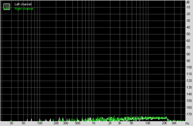

Noise level
Left |
Right |
RMS power, dB | -148.6 |
-148.3 |
RMS power (A-weighted), dB | -149.6 |
-149.2 |
Peak level, dB FS | -132.5 |
-138.5 |
DC offset, % | +0.0 |
+0.0 |

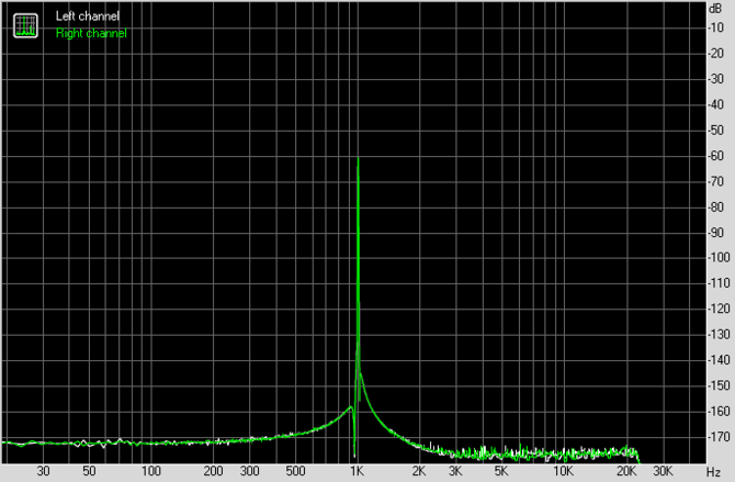

THD + Noise (at -3 dB FS)
Left |
Right |
THD, % | 0.00166 |
0.00165 |
THD + Noise, % | 0.00708 |
0.00705 |
THD + Noise (A-weighted), % | 0.00635 |
0.00633 |

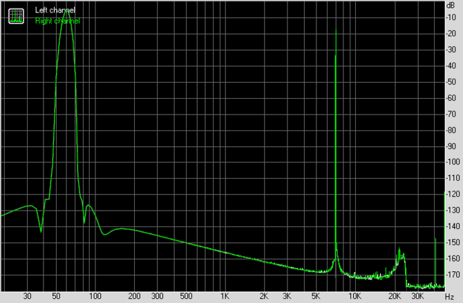

Intermodulation distortion
Left |
Right |
IMD + Noise, % | 0.00862 |
0.00865 |
IMD + Noise (A-weighted), % | 0.00773 |
0.00779 |

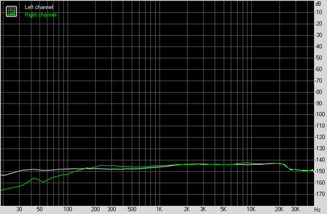

Stereo crosstalk
Left |
Right |
Crosstalk at 100 Hz, dB | -90 |
-91 |
Crosstalk at 1000 Hz, dB | -82 |
-83 |
Crosstalk at 10000 Hz, dB | -80 |
-79 |
IMD (swept tones)
Left |
Right |
IMD + Noise at 5000 Hz, | 0.00928 |
0.00919 |
IMD + Noise at 10000 Hz, | 0.00909 |
0.00925 |
IMD + Noise at 15000 Hz, | 0.00927 |
0.00930 |
