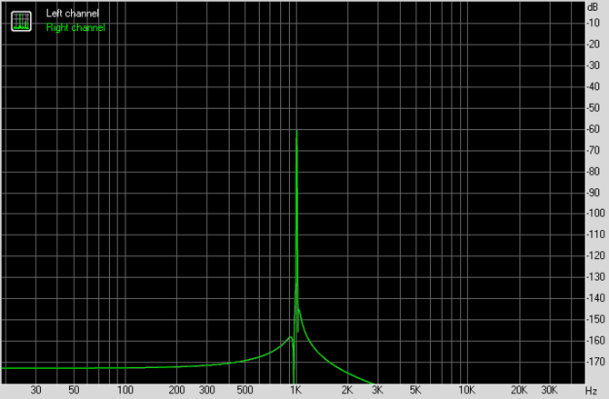

Sound Blaster AE-7 32-bit/96 kHz (wyjście liniowe, tryb bezpośredni)
Tryb bezpośredni przy sygnale o rozdzielczości 32-bitów (stałoprzecinkowe), zgodnie z oczekiwaniami daje takie same rezultaty, jak w przypadku testu wyjścia liniowego przy identycznych parametrach, w standardowym trybie pracy Sound Blastera AE-7.
RightMark Audio Analyzer test report
Testing device | AE-7 32-bit 96 kHz tryb bezposredni |
Sampling mode | 32-bit, 96 kHz |
Interface | |
Testing chain | External loopback (line-out - line-in) |
RMAA Version | 6.4.5 |
20 Hz - 20 kHz filter | ON |
Normalize amplitude | ON |
Level change | -0.0 dB / -0.0 dB |
Mono mode | OFF |
Calibration singal, Hz | 1000 |
Polarity | inverted/inverted |
Summary
Frequency response (from 40 Hz to 15 kHz), dB | +0.00, -0.00 |
Excellent |
Noise level, dB (A) | -207.3 |
Excellent |
Dynamic range, dB (A) | 133.3 |
Excellent |
THD, % | 0.00001 |
Excellent |
THD + Noise, dB (A) | -128.1 |
Excellent |
IMD + Noise, % | 0.00022 |
Excellent |
Stereo crosstalk, dB | -202.4 |
Excellent |
IMD at 10 kHz, % | 0.00002 |
Excellent |
General performance | Excellent |

Noise level
Left |
Right |
RMS power, dB | -206.7 |
-207.5 |
RMS power (A-weighted), dB | -206.9 |
-207.7 |
Peak level, dB FS | -186.6 |
-186.6 |
DC offset, % | -0.0 |
-0.0 |
Dynamic range
Left |
Right |
Dynamic range, dB | +134.1 |
+134.1 |
Dynamic range (A-weighted), dB | +133.3 |
+133.3 |
DC offset, % | -0.00 |
-0.00 |

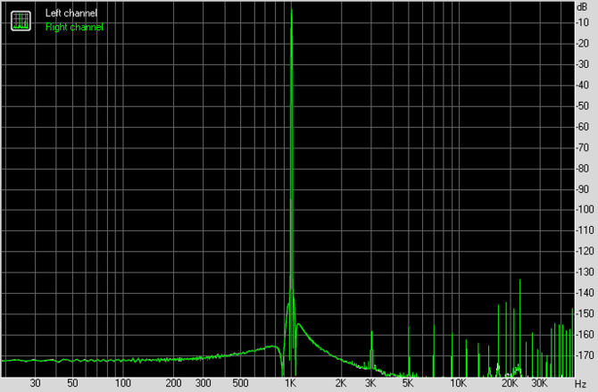

THD + Noise (at -3 dB FS)
Left |
Right |
THD, % | 0.00001 |
0.00001 |
THD + Noise, % | 0.00004 |
0.00004 |
THD + Noise (A-weighted), % | 0.00004 |
0.00004 |

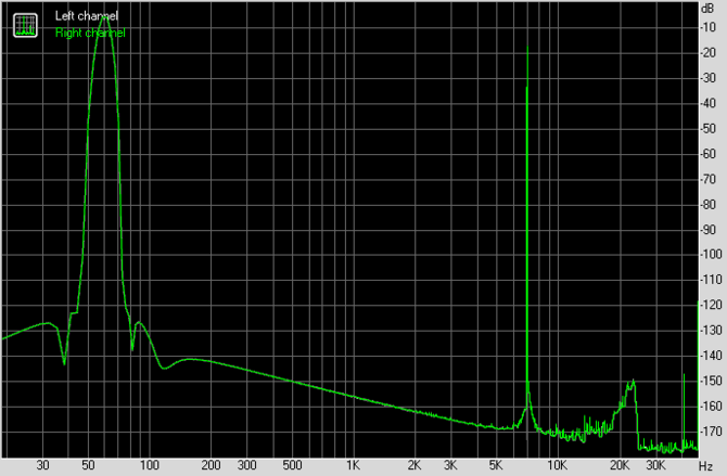

Intermodulation distortion
Left |
Right |
0.00022 |
IMD + Noise (A-weighted), % | 0.00006 |
0.00006 |

IMD (swept tones)
Left |
Right |
IMD + Noise at 5000 Hz, | 0.00001 |
0.00001 |
IMD + Noise at 10000 Hz, | 0.00002 |
0.00002 |
IMD + Noise at 15000 Hz, | 0.00004 |
0.00004 |
